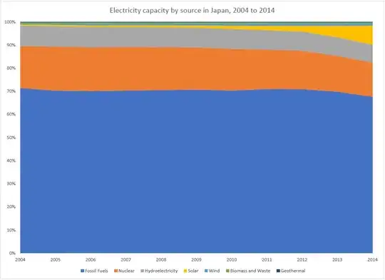

Change in capacity
From 2004 to 2014, nuclear capacity did not change substantially:
Electricity capacity by source in Japan, 2004 to 2014

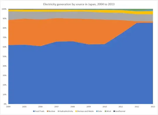

Change in generation
However, the generation mix did change quite a bit (2014 nuclear data not available, so this chart ends in 2013):
Electricity generation by source in Japan, 2004 to 2013
Summary of data
Here's a summary of the data from 2011, along with the two years before and after:
                                2009    2010    2011    2012    2013
    CAPACITY (Million kW)
Fossil Fuels                    182     182     185     189     191
Nuclear                         47      47      44      44      42
Hydroelectricity                22      22      22      22      22
Non-Hydroelectric Renewables    7       8       9       11      18
TOTAL                           258     259     260     266     273
    GENERATION (Billion kWh)
Fossil Fuels                    616     685     795     863     862
Nuclear                         263     280     156     17      14
Hydroelectricity                76      81      82      75      77
Non-Hydroelectric Renewables    27      41      43      56      55
TOTAL                           982     1087    1076    1011    1008
Effect of Fukushima incident
In order to determine how much more greenhouse gases were emitted as a result of the move away from nuclear after the Fukushima incident, let's assume:
  • Hydroelectric capacity is stable and not affected by the change
  • Solar and wind capacity would have grown anyway, and maybe grew a bit faster than if the accident had not occurred, but is still such a small percentage that we can safely ignore it
  • Therefore, nearly all generation shifted away from nuclear was replaced by fossil fuel generation
Prior to the incident, fossil fuels accounted for about 63% of generation, and nuclear was about 26%. After, these numbers shift to 86% and 1%. That means that 23% of the total annual production moved from nuclear to fossil fuel.
If for simplicity's sake we assume the annual consumption of Japan is 1 trillion kWh, this means that about 230 billion kWh's worth of fossil fuels were burned to produce electricity, that would not have been used if the Fukushima incident had not occurred.
