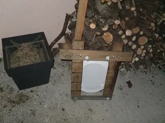

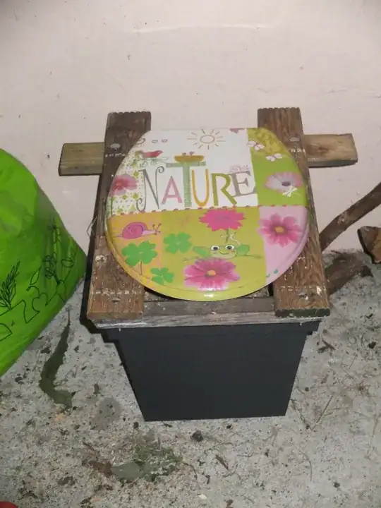

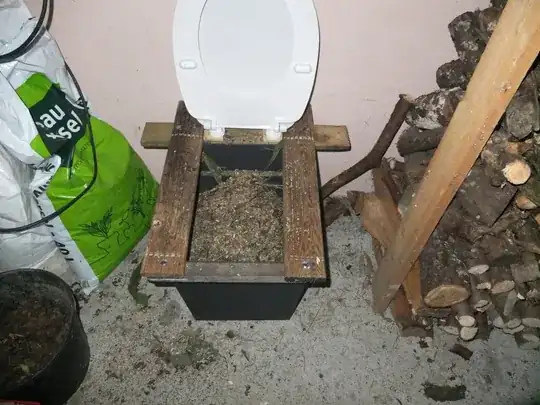

  • It took me 2 hours to install a toilet seat on top of a big square flower pot:
dry, self-composting toilet do-it-yourself dry, self-composting toilet do-it-yourself dry, self-composting toilet do-it-yourself
Edit1 So here is my conclusion for now:
  • Cost of 1 flower pot + toilet seat is about 70$
  • Time spent for a very minimal thing : 2h
  • Expected time to be spent : more than expected - but it will include the new composting pile I planned to do : 4h / month => 50h / year (of hazardous material handling :s )
Edit2
After a while using the thing, I may add comments from experience:
  • Mixing urine with the rest in the bin is a real bad idea, because you have to use extreme precautions when emptying the thing to avoid (deadly) leaks on your shoes or anything. It might have seemed obvious not to put the urine in there to other, but I had to come to this conclusion myself... So I found some other place far back in the yard to empty my bladder beforehand. The mix is also less smelly with this process. Plus, there is no need to complete cleaning is you avoid putting the pee in there: Time saved!
  • Having access to a nearby forest, I rake some decaying leaves in a container. This makes for the material I can use to cover the excrements. It also is better than pure sawdust for the compost I think.
