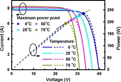

Hybrid photovoltaics + solar thermal
Finally, as Highly Irregular notes in the comments, there are various PV-thermal hybrid systems, which provide both electricity and low-grade heat: in those cases, some of the PV electricity is used to pump water, but the water is heated by the sun directly, rather than by resistance heater - and this cools the PV panel, raising its electricity output:
enter image description here source
There are people trying to combine a PV-thermal hybrid with a heat pump, but the economics really don't favour it at the moment, and current heat pumps can be pretty noisy, particularly in their defrost cycle. A ground-source heat pump + PV-thermal hybrid might be superior to just a heat pump on its own.
