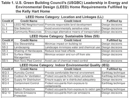

The EarthBag website talks about about LEEDs characteristics, but they either don't answer my main question, or do it in a way that I don't understand.

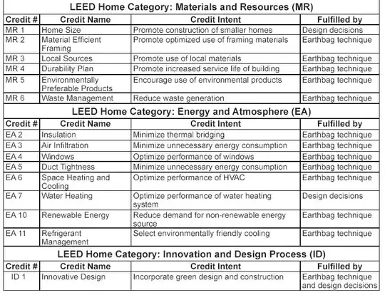

My reading of it is that table 1 is the key summary, and I've copied that here for when that link breaks. The LEED system evaluates a house on a list of criteria and the table lists those and describes how the house fulfils each one. A lot of those criteria may not matter to you, but they're key to some people's definitions of sustainable so they are in there. You can ignore them.
Taking the first item "ND Neighbourhood" they summarise that as "promote responsible land development" which they differentiate from the next item "avoid environmentally sensitive areas" so I take that to be talking about social sustainability rather than ecological. In other words, this is about not going into a poor/affordable neighbourhood and buying a house there that you're going to knock down and replace with a much more expensive one (gentrification). They're achieving that via "design decisions" which I assume means "not buying a site in a poor neighbourhood".
That goes for every point on the list, but because LEED is a proprietary system you need to pay to get access to the details. That IMO makes it less useful as only the people who pay know what it means. By using it you're saying "I'm sustainable, but I'm not going to tell you any details". If a major corporation said that would you believe them?
