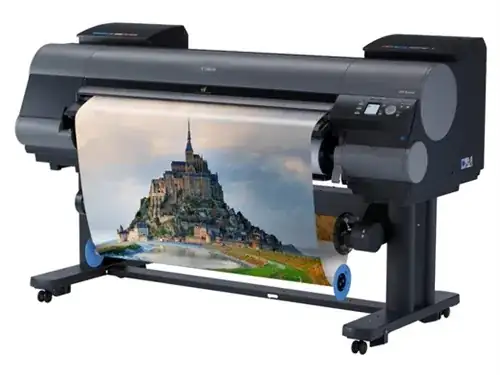

And now, here's a decent ink printer
And here is what it looks like:
