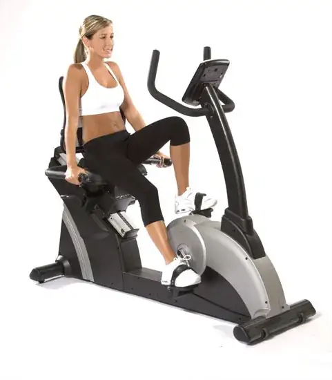

The bicycle is the most efficient machine ever invented in terms of energy conversion.
The idea of converting the energy produced by exercise machines to electricity is hardly new.
Now suppose that your family's house (or apartment) were equipped with a generator, a stationary bike connected to it, and a number of rechargeable batteries.
With four people living in the house with the standard complement of amenities (i.e. two bedrooms, two laptop computers, one TV, one stove, one water heater for the bathroom, air conditioning, heat, eight light fixtures, one phone charger):
... how long would an average person have to pedal to generate enough electricity for one day?
(Should the answer be "Impossibly long," what could be improved: the bike, the generator, or the batteries?)
