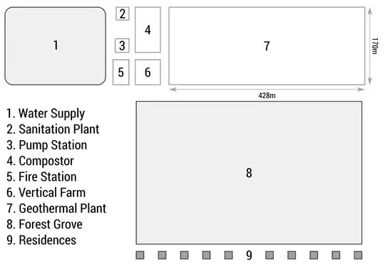

Urban Plan
The purpose of this system is to provide an environmentally-friendly, semi- (or fully-) automated means to produce food for lots of people. Similar in nature to the Earthship question, but delving into a few more details.
