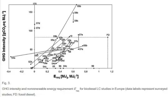

Here's a chart from (2) of all of their studies. Note that the x-axis is the reciprocal of the EROEI, so an x-value of 0.5 is an EROEI of 2, and an x-value of 0.2 is an EROEI of 5. The lines joins together an individual study's findings.

  • It is interesting that all researches report two results, one of them is 20 times better than the second. – Val Feb 09 '14 at 14:28
    @Val, I've taken the extremes of each study: for each study, I've shown the highest and lowest value (and excluded negative values). These studies between them list many many results. – 410 gone Feb 09 '14 at 18:25
