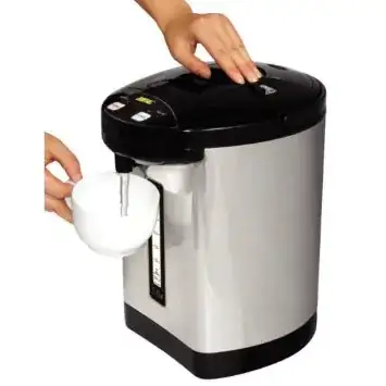

I found a similar product that uses 700 watts while heating but you can select the temp setting if want water . I presume that the heater is just on/off depending on the temp of the water. I would select temperature to be at 140 degrees F, which would save even more or crank only to HI when wanting a cup of 205 degree water.
Product DESCRIPTION: Always have hot water ready at your fingertips with the new Sunpentown Hot Water Dispenser. It features one-touch dispensing, auto re-boil and micro-computerized dry-boil protection. Its multi-temperature function allows you to select and maintain one of three temperature settings. It has a stainless steel body with black trimmings for a sophisticated look. It is ideal for tea lovers or anyone who needs hot water handy. Simply add drinking water and the unit automatically starts to heat the water to the boiling point.
Sunpentown 3.2 Liter Hot Water Dispenser with Multi-Temp Function, Stainless Steel: 1-touch auto dispense 3 temperature selection (208 degrees F, 185 degrees F, 140 degrees F) Stainless steel inner pot Safety lock feature Micro-computerized dry-boil function 120V/60 Hz/700W Dimensions: 10.24"W x 10.24"D x 13"H Model# SP-3203
