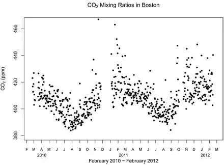

Don't have time to fully address this now, but here's an interesting plot of results from Boston, USA:
BU CO2 Plot
As you can see from this graph, CO2 levels can vary quite a bit over time simply within one city.
You can see a seasonal amplitude of +/- ~12 ppm that's due to plant photosynthesis speeding up (reducing CO2) in summer, and slowing down (allowing CO2 to increase) in winter.
Based on this, you can imagine that areas with different levels of sun or vegetation would then also experience different average CO2 levels as well. From the previous web page:
The CO2 concentration level in Boston is almost always several ppm higher than the global average, because cities, with their buildings and vehicles burning natural gas, gasoline, and oil, are relatively large sources of CO2. For example, in May 2011 the monthly average CO2 level at Mauna Loa was 394 ppm; at BU (Boston University), it was 405.

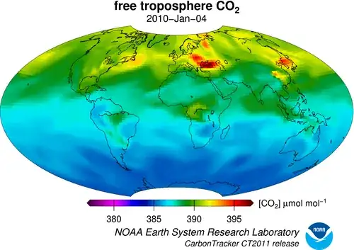

NOAA CarbonTracker
Because it's displaying CO2 1 to 5 km above the ground, it's going to smooth out the variations due to local forests, or power plants. But, you certainly can see areas of high CO2 concentration over eastern Europe / Black Sea (downwind from central Europe) and also China / Korea / Japan (downwind from China's industrial hubs).
