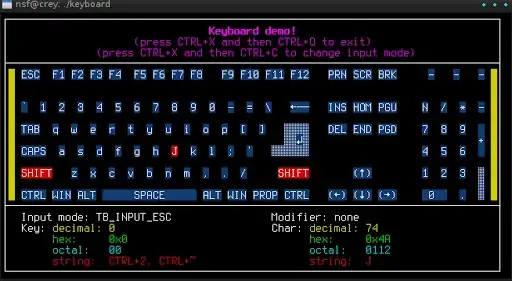

Basically, I need something like this:
termbox keyboard demo

However, the question referred to websocket, which sounds as if this is running in a web browser. The screenshot shows some type of onscreen keyboard, with DEL in the editing keypad.
