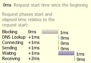

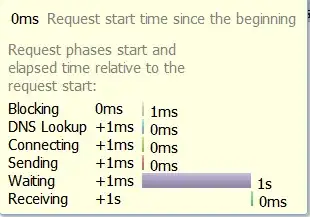

Using Firebug gives us the answer.
http://0.0.0.0 is much faster regardless of whether there is a server running on 127.0.0.1 or not.
Case 1 - http://0.0.0.0:
Case 2 - http://127.0.0.1 (no server running):
Case 3 - http://127.0.0.1 (server running):

  • Thank you! It's interesting to see that 0.0.0.0 is so much faster than 127.0.0.1, especially since 1.02 seconds is not enough time to wait for a full time-out for a server on 127.0.0.1. Any ideas why? – End Anti-Semitic Hate Nov 02 '15 at 21:58
  • In case 2 (127.0.0.1 no server, 1s) there is no full-time out to wait for ... I've added the breakdown of the timeline for case 1 and 2 – DavidPostill Nov 02 '15 at 22:09
  • Interesting. I wonder how it differentiates between "no server on 127.0.0.1" and "server timing out". – End Anti-Semitic Hate Nov 02 '15 at 22:19
