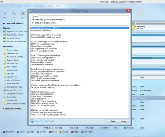

CHKDSK FINDS NO DISK ERRORS; NO LUCK SEARCHING GOOGLE FOR ERROR MESSAGES
Per the message I ran "Check File System" in Partition Wizard. It was just a gui wrapper for the windows "chkdsk" command. No errors. No bad sectors. Everything appeared to be fine.
Results of Check File System process:
(Click image to enlarge)
Also, I was unable to find anything useful in Google about "Failed to load disk IO driver: Error Code:2" or "Win32 Error Code:5". That tells me that the error I'm getting may be relatively rare.
