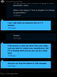

On 'Answer Tech', live Microsoft's technicians all answer the same epic crap (they all prefer blaming the manufacturer, asking the customer to return his computer (!!!!) than answering that they do not know). This one was particularly good :
epic crap
