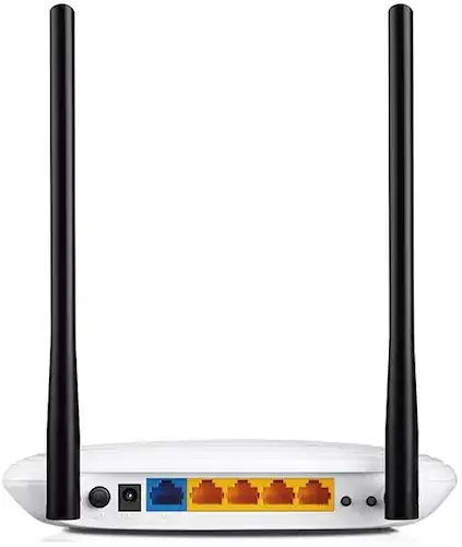

So both routers are exactly the same model? Both are the TP-LINK (TP-WR841N)? According to the specs, that router can only use two 5dBi fixed omni directional antennas at one time. And even looking at a picture of the back of the device from TP-LINK’s website only shows two antenna connectors already populated:

Short answer: your router have only 2 jacks, you can't install more antennas.
