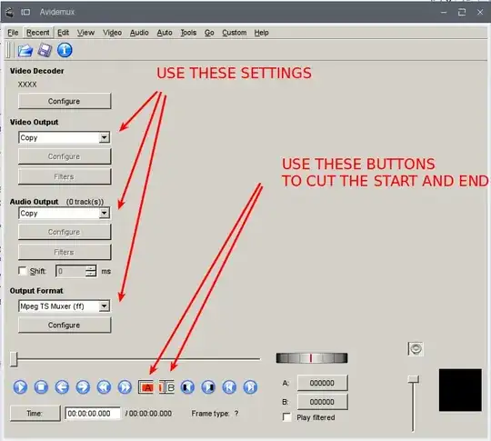

As a GUI solution, I have tried Avidemux but with bad results. When searching a Linux solution I have found this comment here pointing to Avidemux nightly:
"You can try Avidemux, but not the stable one. You should try the win32 version (yes, for windows) with "Wine". It supports H.264 and you must use the double arrow to find out the keyframes because you can[not] cut everywhere (due to the "long gop" thing...). But, as every software like this, you can do JUST CUTS otherwise it will render (in case of transitions, effects, ectc.). http://avidemux.org/nightly/win32/"
I have tested that in Linux/Wine but it should work in Windows too.
To join files, use File-Open to add first file, and then File-Append for the rest.
To save: File - Save.
