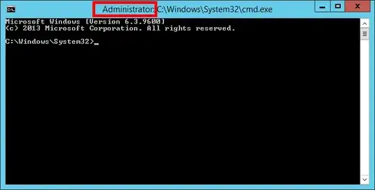

Related to my other question, I need to be able to run the command prompt NOT as an admin. Whenever I launch a command prompt, either from the Start Menu, or by double clicking the C:\Windows\System32\cmd.exe file in File Explorer, it runs it with elevated permissions.
Cmd.exe running as admin
How can I run it so it just runs in the normal non-elevated mode? Cmd.exe isn't required to be ran as admin, and typically when you launch it, it doesn't run as admin, but for some reason it is defaulting to run as admin on this machine. This is on a Windows Server 2012 R2 server. My account I'm logged in with has admin privileges (but it's not the default built-in Administrator user account), and the only workaround I can think of is to run it as a different user that does not have admin priviledges, which would require me to first create a non-admin account on the server, which seems excessive. Is there an easier way?

  • Never tried this, but create a cmd shortcut on the desktop, do a properties on the shortcut, then hit advanced button on shortcut Tab, can you uncheck run as admin? – Moab Sep 28 '15 at 19:53
  • Do you see anything in the Win-X menu (or right-click Start button), when running as as admin? (not in a position to test from server version at the moment.) – paradroid Sep 28 '15 at 19:53
  • @duDE I tried runas and it did launch the cmd.exe as another user, but still as an admin. Titlebar was Administrator: cmd.exe (running as Domain\Username). @Moah I tried that as well, but the shortcut does not have the run as admin checked. @paradroid Win+X does list both Command Prompt and Command Prompt (Admin), but they both launch the command prompt as admin. Thanks for the suggestions though guys :) – deadlydog Sep 28 '15 at 20:05
  • you can use Process Explorer from Sysinternals. Open Procexp as admin, and then go to File -> Run as Limited User. A run bar will appear, and you can enter cmd or whatever else you want. https://technet.microsoft.com/en-us/sysinternals/ You are correct, Runas will always elevate if the user is capable of elevation. you could create a non-elevatable user, and run as them though if you really want to use runas. Procexp is easier. But make sure that cmd.exe is not marked to always run as Admin under the Properties -> compatibility tab. – Frank Thomas Sep 28 '15 at 20:32
  • "My account I'm logged in with is an admin" AFAIK there is a reg and/or gpo hack to make a server admin run everything elevated. Do you have this on? And/or do you have UAC off as @kreemoweet implied? – underscore_d Sep 28 '15 at 23:44
  • Yeah, I had UAC turned off. Turning it on and rebooting fixed the problem. Interestingly, I turned UAC back off and rebooted and the problem did not return; I'm able to launch cmd not as admin like usual again now. Maybe the server just needed a reboot. – deadlydog Sep 29 '15 at 02:27

Turn UAC back on. With that enabled, no program you start will automatically run as administrator.
