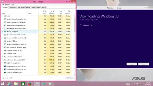

I just upgraded from 8 to 8.1 and immediately tried upgrading to windows 10. I got this same error so I killed the process and retried and restarted my computer a few times.
I turned off automatic updates thinking maybe I was getting the issue where it shows 0% because an automatic update is already in progress. Still nothing. It's just sitting there.
*side note - it won't let me close it unless i end process from task manager.
