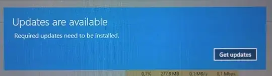

Today I got the following message:
Computer was frozen and the only button available was "Get Updates".
I don't need this feature, I need to work, not serve my machine the time she wants.
Currently I did cold reboot and had time to open task manager and process explorer on different screens before the message appears again. Due to the bug in the application, I was able to kill MusNotification.exe process.
Unfortunately, I am unable to restrict system access to musnotification.exe and musnotificationux.exe files, or add them to antivirus blacklist.
How to ban this feature?

    I don't like disturbance while thinking. I agree to setup either automatic or manual download / install. I disagree to setup annoying messages. Imagine 100 programs asking for download each day -- when you would work? – Dims Sep 14 '15 at 10:01

    @fixer1234 I agree with notifications, but they should not block my screen – Dims Sep 15 '15 at 12:48
  • Thnx. Can say additionally, that when I was experimenting with killing musnotificationux.exe program, I found, that notification is still appearing, but as normal tray notification: this is a way to notify myself (everybody) prefer. – Dims Sep 16 '15 at 11:36
From my observations, "restrict system access to musnotification.exe and musnotificationux.exe files" is an effective method of blocking that message, if you have administrator privilege.
Paste these lines to elevated cmd to deny Everyone from executing the two files:
cd /d "%Windir%\System32"
takeown /F MusNotification.exe
icacls MusNotification.exe /deny Everyone:(X)
takeown /F MusNotificationUx.exe
icacls MusNotificationUx.exe /deny Everyone:(X)
rem
I have managed to create a Hyper-V virtual machine that can test this "feature".
  1. Clean install Windows 10 Enterprise LTSB
  2. In gpedit.msc change Windows Update to Notify download
  3. Check for updates, but reboot when it begins to download.
  4. Run usoclient StartScan and wait for the CPU usage to drop to normal. Save a virtual machine checkpoint.
Now, changing the system date to one month later (!) will 100% immediately trigger the "Updates are available" message.
However, if I restore the checkpoint and paste the commands above, changing the date will do nothing special.

The only way i found around this crap is to switch the MusNotificationUx.exe for something less annoying, lets say cmd.exe or somesuch. Sure, a window still opens, but it's not blocking the entire machine.
To do this make sure you change the owner of the file appropriately (away from TrustedInstaller) and set file access accordingly. Then replace the file.
This "feature" is a slap in the face for anyone using Windows 10.
When the window opens, clicking anything will open the update panel and it will set a restart time for the updates to apply. This is fully undesirable.
There is a simpler trick to close the window without touching it:
  • Hit Ctrl+Shift+Esc, the task anager appears in the background
  • Hit Ctrl+Tab to navigate to the Details tab
  • Hit Tab to focus the processes list
  • Hit M, U, S, N or the keyboard arrows to reach the MusNotificationUx.exe item
    • Killing MusNotification.exe does not do anything
  • Hit Del to end the task
  • Hit Enter to confirm. The window gets killed.

If you want to get out of this lock screen, you should left-click on any part of notification that's not the button and press ESC. Makes the notification disappear for me
