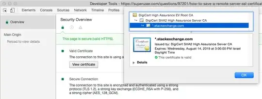

Exporting a certificate using the Chrome browser
  1. Connect to the website using SSL (https://whatever)
2. Click on the lock symbol and then click on Details
  1. Since Chrome version 56, you do the following: go to the Three Dots Menu -> More Tools -> Developer Tools, then click on the Security Tab. This will give you a Security Overview with a View certificate button.
  2. Click on the View certificate button.
    A modal window will open. It has two panes. The top one shows the trust hierarchy of the site's certificate (the last one listed), the intermediate certificate(s), and the root certificate (the topmost one).
    The second, larger pane, shows the details of one of the certificates.
    There may be zero or more intermediate certificates.
    Note that the root certificate has a gold-bordered icon. The others have a blue border.
    See the screen shot below.
  3. To export a certificate:
    1. First click on the certificate's icon in the trust hierarchy.
    2. The certificate will be shown in the main part of the modal.
    3. Click on the certificate's large icon in the main part of the modal. Drag the icon to your desktop. Chrome will then copy the certificate to your desktop.
