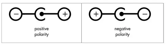

  • Other than checking polarity of the plug, It should work fine, I have done this many times, if voltage is within 1~2 volts and amperage is same or higher you are ok. – Moab Sep 09 '15 at 15:35
No, that's well within the tolerances of both supply and laptop, you shouldn't have any problems assuming both have the same pin configuration, almost certainly centre-pin positive.
Be aware though that many laptops feature "intelligent" charging which attempts to ensure that an approved supply is being used by interrogating a chip inside the charger. In this case you may be presented with a "this accessory is not supported/may not work" or it may refuse to charge at all.
