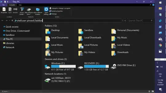

To get there quickly without worrying about Explorer view options, click in the Explorer Address bar and type:
shell:User Pinned\Taskbar:
For a list of names that can be used with Shell:, copy & paste the following into a PowerShell console window:
$FD = 'HKLM:\SOFTWARE\Microsoft\Windows\CurrentVersion\Explorer\FolderDescriptions'
(Get-ItemProperty (Get-ChildItem $FD).PSPath).name | sort
