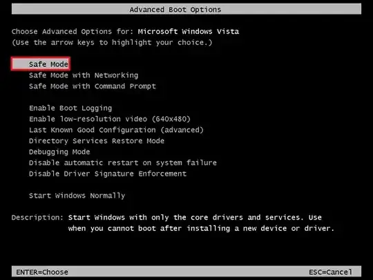

How to remove a forkbomb from the Startup folder?
Start your PC in "Safe Mode" (Startup programs do not run in safe mode, and only the basic drivers needed to start Windows are installed).
Then you can delete the offending batch file.
How To Start Windows Vista in Safe Mode
  1. To begin entering Windows Vista Safe Mode, turn on or restart your PC.
  2. You will see the Splash Screen
  3. Before the Windows Vista splash screen appears, press F8 to enter "Advanced Boot Options"
  4. Select "Safe Mode" and press Enter
Screenshots:
**strong text**
Source How To Start Windows Vista in Safe Mode
