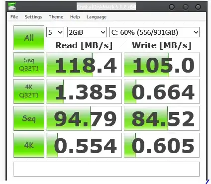

Info from Crystal Disk Marks

If you didn't find an offending process, you should find a benchmarking tool (since you've already used CrystalDiskInfo, I recommend CrystalDiskMark). Run a benchmark on the drive and search the web for other peoples' results using the same benchmark program on the same or similar type of drive, and see if your drive's performance is reasonably close. Post your benchmark results here too so we can see them.

  • Added some benchmarking, the problem now manifests itself as high disk usage regularly with long >10sec average response times. If I am doing any sort of disk access machine starts to drag – Ben Whyall Jul 07 '16 at 21:50
