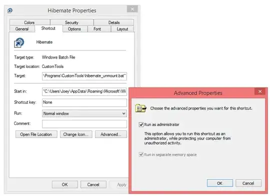

Shortcut properties showing 'Run as administrator' option
Lastly, to unmount a partition, you must have Administrator permissions. You can do this, but creating a shortcut of the batch file below, and tick Advanced > Run as administrator on the Shortcut panel.

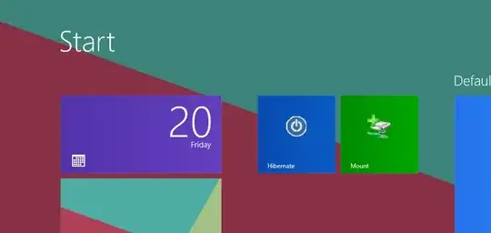

In Windows 8 you can access this from your Start Menu by placing this shortcut in your C:\Users\<username>\AppData\Roaming\Microsoft\Windows\Start Menu\Programs directory, or globally, C:\Users\Default\AppData\Roaming\Microsoft\Windows\Start Menu\Programs.
Start menu showing hibernate mount/unmount icons.

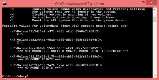

To remount the drive after you have come out of hibernation, you will need a Mount shortcut as well. This will look like:
mountvol <DRIVE LETTER> <VOLUME ID>
To find the volume ID of your partition, type mountvol into cmd. This shows a list of the partitions in your computer. If you have already unmounted the drive you are wanting to re-mount, it may say *** NOT MOUNTABLE UNTIL A VOLUME MOUNT POINT IS CREATED *** underneath it (as shown below).
