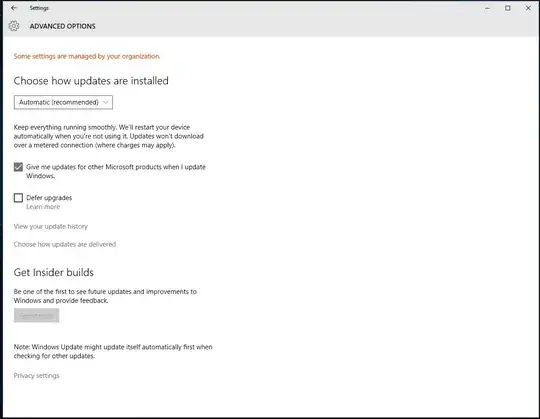

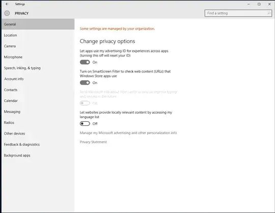

So, I installed Windows 10 Pro 64-bit yesterday and have been configuring it since. Somewhere along the way a setting got triggered somehow which results in a message "Some settings are managed by your organization." I would like to know how to correct this.
I am not part of a domain, this is a home computer and there is one user account, mine, with administrator privileges.
Figure 1 Figure 2

This message is misleading, at least in the Windows Update dialog.
This is based on that in the privacy settings under "Settings" -> "Privacy" -> "Feedback & diagnostics" -> "Diagnostics and usage data" it is set to "Basic". Change it to "Enhanced" or higher, the message disappears.
I have a German Windows 10 Professional version, so can not say exactly whether the menu names are correct. However, this must be increased.

    I have checked and double-checked the settings. They are already set to "not configured." I uninstalled my anti-virus and disabled automatic logon in netplwiz. To no avail. I left my homegroup, created a new homegroup, left that one, ran gpupdate as both regular and elevated prompt. – headkase Jul 30 '15 at 20:04
    @headkase Try checking in the User Configuration tree as well? If you go to All Settings under Administrative Templates and sort by State, you'll be able to easily see which if any policies are configured. – Ben N Jul 30 '15 at 21:41
  • Not configured for everything. The only two functions that I have found that I am unable to access, given in the screens above, is that I cannot join the insider program, and also I cannot send typing telemetry to Microsoft. – headkase Jul 30 '15 at 21:45

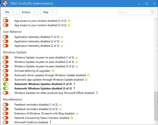

Since none of the answers in this thread worked for me, here is what did work: O&O ShutUp10. It's a free piece of software that gives direct control over your security/privacy policies. So for example, if your Windows Update functionality is locked, it will look something like this:
screenshot
Green/On means the setting is disabled. So just switch those to the Off position to revert control back into your hands.
There's another similar piece of software called Spybot Anti-Beacon, but it's interface is a bit less intuitive.
