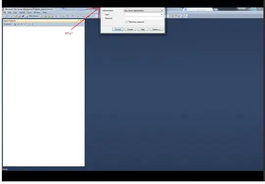

When running SQL Server Management Studio 2014, the Connect Object Explorer window always starts off-screen:
Broken SQL
I've tried the ALT+SPACE+M trick from this SU question and that works to move it, but when I close or cancel out of the Connect Object Explorer window and re-open it, it's back there again. The SHIFT on close doesn't work for this.
I have a dual monitor setup where one monitor is portrait and one monitor is landscape. The problem only happens when I open SSMS on my landscape monitor, which is the default.
Is there a way to force it to open center-screen?

Generally speaking; Change the resolution on the monitor, or change the virtual position of your monitors to move the window. Move it to where you can see everything then use it or close with with something other than "Cancel" this can change the grid location it loads at.

  • I have to admit I wasn't hopeful about the virtual position of the monitors. In this image: http://i.imgur.com/4APzXbG.png, the left side was what I had, the right side was what I changed it to and it worked. Kind of frustrating that it works like that but it makes sense. Any tips for what part of the registry I'm hacking to fix the position for SSMS 2014? :) – Brandon Jul 29 '15 at 14:51

  • Coming back to this, looking at your image, @Brandon, I think I see what's going on. The program is taking the height of your monitor, dividing by 2, and then subtracting half the height of the Connect Object Explorer dialog, to determine the y coordinate for the top of the dialog, with the intent of centering the dialog vertically on your screen. But since your left monitor's top edge is not at y=0, the y coordinate that Studio chooses is too high. I'm curious whether you'd see any different result by swapping the cables so that your left monitor is identified as "1" in the display settings. – Dan Henderson Sep 10 '20 at 15:36
