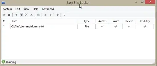

    Hm. The difference might be that the other file was held open by the DB server and thus could not be deleted. Could you repeat your tests after locking the file? – Bob Jul 27 '15 at 04:49
  • Might also try locking just delete so read/write is still possible (specify "ReadWrite" instead of "None"). Just in case the DB server operates in that mode, as unlikely as it is. – Bob Jul 27 '15 at 05:20
  • Hi Bob, may you suggest how to lock, or can you do a test and is it the file really amended or not. Thanks – Shiro Jul 27 '15 at 06:26
  • (Bob already linked to a lock utility and another option in his comments.) – Arjan Jul 27 '15 at 08:11
  • But the problem is my situation my db file, I did not have "the process cannot access the file because it is being used by another process." I can just paste it. Can I use checksum to verify? – Shiro Jul 28 '15 at 05:14
  • OK, thanks for the easy file locker program. I manage to simulate the case. – Shiro Jul 28 '15 at 06:07
    Since you answered the question yourself, and quite extensively, I refunded the bounty, also considering that there are no other answers. This is more of an exception though. – slhck Jul 28 '15 at 07:38
Thanks for all the comments. The conclusion is even through only few percentage is copy. The file confirmed amended.
Below is the case study.
With Delete Checked, If it only few percentage copied. I press cancel. The fill will be delted.
With Delete Checked, If it only few percentage copied. I press cancel. The fill will be deleted.
Next, I changed the deletable to unchecked. With this option, when I cancel the copy operation, the original file will not be deleted. enter image description here
I noted down both a\dummy.txt and b\dummy.txt checksum.
As I copy b\dummy.txt and immediately cancel it. I run the checksum to check the file. It is confirmed the checksum is different.
So by this testing. I can concluded that if you copy a file, even through you cancel it. The file already amended.
Thank you everyone for you comment contribution. So do backup first before overwrite your file.
