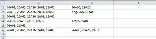

I've two collumns in excel and I want to see if there is a common word(s) betweeen my cells, for instance:
Cell A1: 76A08, 26A65, 22A26, 2A01, 12A05
Cell B1 I've : 26A65, 22A26
In cell C1 the result exepted is : 26A65, 224A26
I have over 7000 rows.

Before

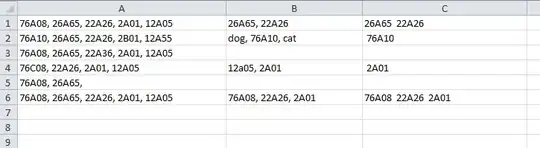

After

  • Oh you're genius! That was the title, by deleting it it works! One other issue, as sometime i met blank cell the macro stop :/ – luc Jun 30 '15 at 09:15
