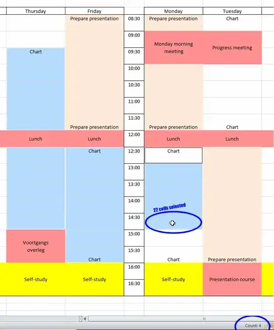

There are two use cases. I need use case 2 right now:
  1. When I make one or multiple selections, I want to know how many cells,
  2. I want to select exactly N cells using multiple selections. I keep making and resizing selections until the number (which should be live on the screen somewhere) reaches N
For #1 I have a workaround: Select single cell containing text, copy (so it has an animated border), then make your selections, press paste, and read the count in the status bar.
For #2 I don't know a workaround that doesn't involve repeating workaround #1 dozens of times and then pressing undo.
  • Is point 2 saying you know you want to select A3:A6 and B:5 to B:11 and C1:C22 and you want to have a quickway to select them? – Dave May 28 '15 at 09:50
  • #2 could also be done with VBA but it is complex as you would need a way of accumulating the answer between cell selections. Possibly a button to start and another to reset. It would take a lot of working out. My advise would be to create a second question stating what you wanted to ACHIEVE so that you get some alternative approaches. – Julian Knight May 28 '15 at 10:09
  • No, @Dave, I know I want to select, for example, 40 cells, and then I want to make selections in between existing appointments (like the image), until 40 cells are selected. – Mark Jeronimus May 28 '15 at 11:40
  • What is wrong with holding down CTRL and selecting the cells you want? Or do I still not understand the question :S – Dave May 28 '15 at 11:42
