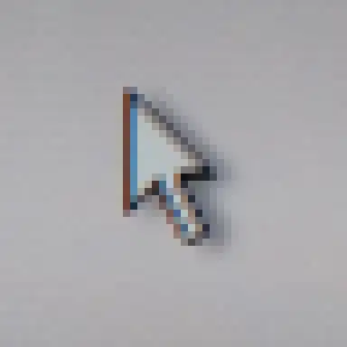

I recently noticed my cursor was whiter than the background white (pure 0xFFFFFF). I originally thought it was an optical illusion as taking screenshots showed that both the background and the cursor were at 0xFFFFFF. Then I took a photo of the cursor and it clearly shows a difference in brightness:
Photo of cursor
I put a mosaic filter on the image to see the average brightness better:
Photo of cursor with mosaic filter
The interior of the arrow is about 191 grey (0xBF) and the background is about 177 grey (0xB1), meaning the white of the cursor is about 8% brighter than the pure white of the background.
What hardware is doing this and how? Is the colour information being transmitted with more than 8-bits per channel?
The computer is Windows XP with an NVIDEA GeForce 8500 GT graphics card connected to a Samsung 5100 TV via an HDMI cable.

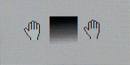

Another photo:
Two cursors and a shaded square
One hardware cursor, one screenshot of the hardware cursor and a 16x16 square of each grey scale value from 0 to 0xFF in 2x2 blocks.
Two cursors and a shaded square with mosaic filter
The same as the previous image but with a mosaic filter applied. It should be obvious which is the actual cursor and which is the screenshot of the cursor in the photo. The brightness this time is 185 and 170, still about 8% difference. Using a colour picker, the colour that is 170 in the photo is 0xFFFFFF on the screen. I can't use the colour picker on the cursor itself because it samples the colour directly under the cursor.
