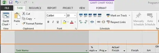

The whole area in the orange box is totally useless and I can't figure out how to get rid of it. It's wasting a tremendous amount of vertical space.
I can collapse the ribbon, but this wasted space just slides up.
Project 2013 whitespace fail

It looks like you have increased the height of your header row. Place your mouse above the first task ID on the left side. Your mouse should look like a thick black line with arrows pointing up and down. Press and hold down the mouse button. Drag up to decrease the height of the header row.

  • Indeed, I can make it even more egregiously taller, but no shorter than what you see in my screenshot. FWIW I did try what you're suggesting first and probably should have mentioned that. – Adam Wuerl Apr 23 '15 at 06:02
  • Can you post a picture of the right side (timescaled portion) of the view? Does this occur in all project files or just one? The only way I can reproduce your error is to go to 3 tiers in the timescale and then increase the font size of the timescale text.

  • Done. This alone was helpful advice as I know it's something I've done to my file and not a problem with Project per se. – Adam Wuerl Apr 23 '15 at 21:59
It's happening because one of the columns in my Gantt chart has a long title and I'd squeezed the column width to be very small. (See the title and width of box in screenshot below). The Field Settings dialogue for that column had Header Text Wrapping box checked, which was causing the header height to grow, even though the text wasn't visible regardless of height.
Checkbox for header text wrapping
I fixed it by unchecking this box for all visible columns. Note: I tried to select all the columns at once and unchecking the box, but this didn't take. That may just be a bug in Project.
