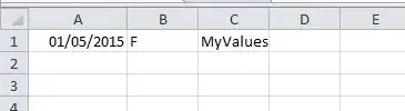

Worksheet 1:
Worksheet 2 after I run the macro
