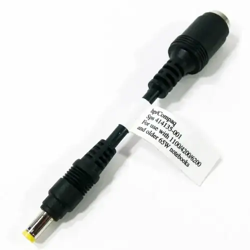

It sounds like you're talking about an HP Smart charger. I wouldn't recommend using this with a non-HP device. However, if you'd like to change the plug to an older style, HP does offer an adapter for this.
