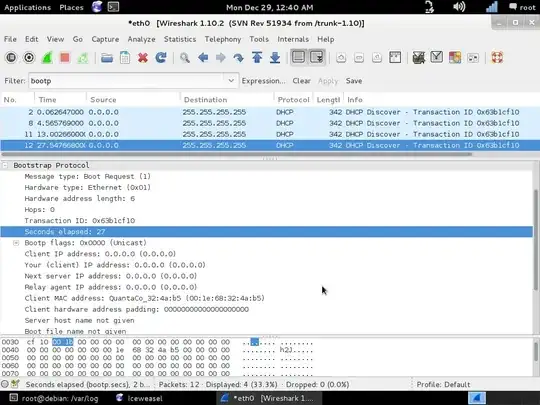

I cannot get this laptop, Craptop, to connect to the Internet using the eth0 interface, but it can connect using the wlan0 interface. NetworkManager, managing eth0, times out when trying to find a DHCP server (present as my home router, 192.168.0.1).
A different laptop, Deltique, can connect and negotiate DHCP just fine using the same Ethernet cable.
After asking Wireshark to monitor eth0 on both machines, I found that Deltique negotiated an IP address with 192.168.0.1 after sending a broadcast on 255.255.255.255, but Craptop sent four DHCP broadcasts without receiving any reply.
It seems that the Ethernet port on Craptop is functional, since it can detect when I plug in the wire, but why can't Craptop receive any packets?
Is Craptop missing a driver? How can I troubleshoot this further?

Wireshark: DHCP packets
[Screenshot of Wireshark]
