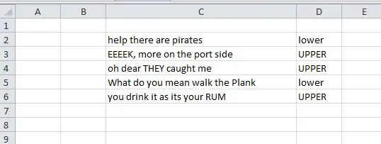

Your question isn't clear, but this should get you going

Before
After VBa run
Also see How do I add VBA in MS Office?

  • Yes Dave, i want the 2 char uppercase beside should show UPPER. this is working for me, but few it is capturing the as UPPER when the Uppercase is not avilable.

  • @KiranSakaray, I've updated the code, please try now] – Dave Dec 19 '14 at 15:16
  • That's working fine for all the cells Dave.

  • Fantastic you made my day, it was taking 3 hrs me to separate the UPPER & lower case. Now I can run the macro in 4 mins. – Kiran Sakaray Dec 19 '14 at 15:51
  • Pleasure @KiranSakaray, glad it is working for you – Dave Dec 19 '14 at 15:53
