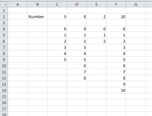

How do I automatically change the length of a column with the numbers 0-n, where n = a number in a certain field?
I'm thinking of something like this:
EDIT: Seems like I was bad at explaining exactly what I would like. Here's a second try I'm looking for a solution that will allow me to input one number in a field which would create a column of numbers from 0 to the input number. Here's what it would look like with different numbers. Note: I only need one field for number input, which would then create the column of numbers, as illustrated.

Here is some code to get you started (based on the cell placement in your image).
Sub SeriesFill()
    Dim RowCount As Long
    Range("C4:C1000").Cells.Clear
    RowCount = Range("C2").Cells.Value + 4
    Range("C4").Cells.Value = "0"
    Range("C4").AutoFill Destination:=Range("C4:C" & RowCount), Type:=xlFillSeries
End Sub
This was tested in Excel 2010. You will need to determine how you are going to trigger it and modify it to work on other columns.

This does what you want.
In your example, you have 4 columns (C, D, E and F). Well, you could add another (G, H, I, J etc) and the code below will still execute for all of these columns.
You will need to tell it a few things though, such as rowsRequired (in this case this is row 2, it is the row where you define the requirements (such as how many values you want)).
You need to tell it what row to start pushing the results, in this case I chose row 4
You need to tell it the starting Column, in this case C
Sub DoTheThing()
@AHOY ME HEARTIES, SEE BELOW FOR WHAT YE CAN EDIT
Dim rowsRequired As Integer
rowsRequired = 2  ' THIS IS THE ROW NUMBER WHERE YOU ENTER THE NUMBER YOU WANT TO SEE
Dim startingRow As Integer
startingRow = 4 ' THIS IS THE ROW NUMBER YOU WANT TO START SHOWING RESULTS
Dim startingColumn As String
startingColumn = "C" ' THIS IS THE FIRST COLUMN
'I SUGGEST YOU LEAVE THE BELOW ALONE LESS YE WALK THE PLANK
Dim startingColumnInt As Integer
startingColumnInt = Asc(startingColumn)
Do While (Range(Chr(startingColumnInt) & rowsRequired).Value <> "")
    Dim valToUse As String
    valToUse = Range(Chr(startingColumnInt) & rowsRequired).Value
    Dim row As Integer
    row = startingRow
    Dim i As Integer
    For i = 0 To valToUse
        Range(Chr(startingColumnInt) & row).Value = i
        row = row + 1
    Next i
    startingColumnInt = startingColumnInt + 1
Loop
End Sub

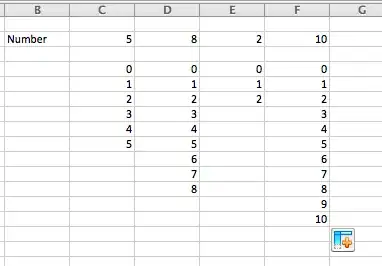

Before
After VBa executes
