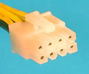

I was reading this article, and a question came to my mind.
8 pin EPS12V power cable
8 pin PCI Express power cable
Besides the name and the color, these 2 connectors look the same.
  • Is there a case where one should be used over the other?
  • Is there any difference between these 2 connectors?
  • Is the color of the connector a correct way to distinguish them?

They are completely different.
The EPS connector is meant to supply power to a motherboard cpu socket while the PCI express connector is meant to supply power to a GPU.
You shouldn't be able to switch between them - the square and rounded off connectors are arranged such that you can't. Note the top left connector on the EPS 12V is squared off, while that on the PCIe is rounded off in the image before.Essentially differences like that are to prevent you from plugging in a PCIe connector into a EPS12V. There may be other differences, but I don't have these connectors on hand/
The power connectors are different - while they're both 12V (yellow) and ground (black) the row closer to the clip of the PCIe connector is ground, and the bottom is 12V, and its the other way around on the EPS 12V.
Here's a much bigger/better picture of them taken from the computer hardware chart done by Sonic840 on Deviantart (CC BY-SA)
Attempting to switch between them will result in physical damage, from attempting to fit physically different connectors and electrical damage, from reversing the power feeds to the device. I'd recommend inspecting the connectors (which are typically labelled), as well as the order/colour of the power cables connected to the connector in working out what a cable is. Connectors themselves however are not typically colour coded in any way.

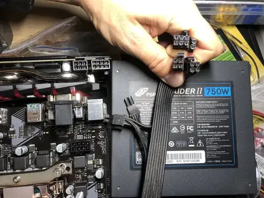

Unfortunatelly it's not true that you cannot connect PCIe 8-pin plug to EPS-12V (EATX) motherboard slot. It might be only an exception found with FSP PSU, but a single difference in one male pin on PCIe connector allows to plug your PSU totally wrong.
PCIe and EPS-12V FSP PSU plugs comparison against GPU PCIe socket and motherboard EPS-12V socket:
Picture.
See the picture: top left GPU PCIe socket, top right PCIe plug, bottom left motherboard EPS socket, bottom right EPS plug. As you can see, the top right pin of PCIe plug is rounded which allows to accidentally plug it to motherboard EPS socket.
This way one could easily destroy motherboard/CPU components. I don't know if this is the only PSU having this flaw, I haven't seen PCIe plug with rounded top right pin on Corsair PSUs.
