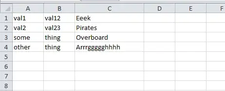

This is VBa, there is no undo, so before you do it, take a back up of your file first!
Option Explicit
Sub WalkThePlank()
Application.ScreenUpdating = False
Dim startRow As Integer
startRow = 1
Dim row As Integer
row = startRow
Dim bRow As Integer
'sharks below cap'ain
Do While (Worksheets("Sheet1").Range("A" & row).Value <> "")
    Dim aVal As String
    Dim bVal As String
    aVal = Worksheets("Sheet1").Range("A" & row).Value
    bVal = Worksheets("Sheet1").Range("B" & row).Value
    'I see thy booty
    bRow = startRow
    Do While (Worksheets("Sheet2").Range("A" & bRow).Value <> "")
    Dim aVal2 As String
    Dim bVal2 As String
    aVal2 = Worksheets("Sheet2").Range("A" & bRow).Value
    bVal2 = Worksheets("Sheet2").Range("B" & bRow).Value
    If (aVal = aVal2 And bVal = bVal2) Then
        Worksheets("Sheet1").Rows(row).Delete ' we found a traitor, feed em to the sharks
        row = row - row
        Exit Do
    End If
    bRow = bRow + 1
    Loop
row = row + 1
Loop
End Sub

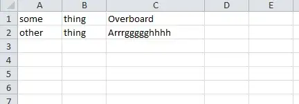

Screenshots:
Sheet1
Sheet2
And after I run the macro Sheet1 looks like (Sheet2 remains unchanged)
