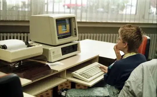

IBM 5150 PC
IBM original 5150 PC. Photo by the German Bundesarkiv, photo accession number B 145 Bild-F077948-0006, CC-BY-SA. Equipment design circa 1981, photo 1988. Image source

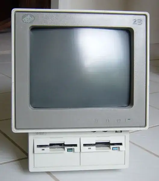

IBM PS/2 model 25 with integrated CRT monitor
IBM PS/2 model 25 PC with integrated CRT monitor. Public domain photo. Equipment design circa 1987. Image source

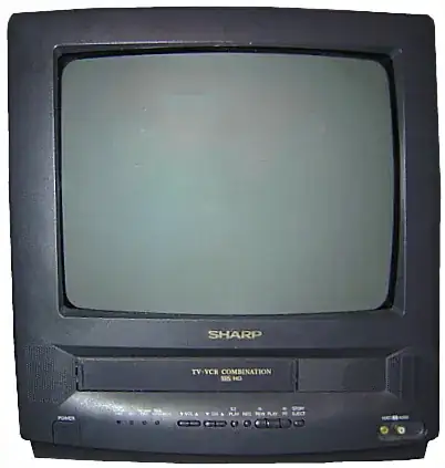

Sharp TV/VHS combination unit
Sharp TV/VHS combination unit: a CRT TV and VHS player combined into a single device. Also notice the speaker grille immediately adjacent to the VHS casette slot. Photo by Bryan Derksen, CC-BY-SA, circa 2005. Image source
