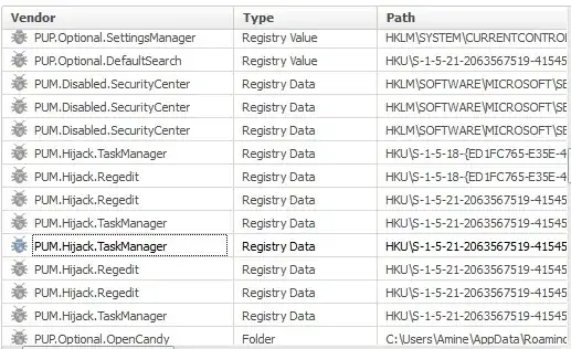

Example of the problems Malwarebytes has found: Example of the problems Malwarebytes has found

  • What "suspicious things" have been quarantined? What was the exact "80070005" error message? Please edit your question to include this info. Help us to help you... – DavidPostill Nov 06 '14 at 13:25
