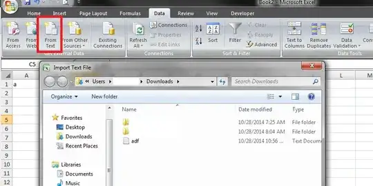

For saving
You need to adjust the list separator in language and regional settings prior to saving the file -
For opening
Go to Data - Get External Data - From Text
select the file
Select delimited, press next enter image description here
and select the delimiter comma
Click finish
Or, pull it in and then use text to columns see here
