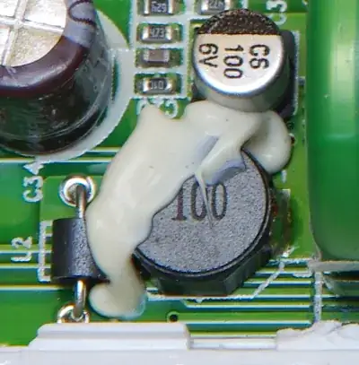

This is why you sometimes see weird gobs of glue on coils inside electronic devices. The glue helps reduce the vibration and noise the coils generate during normal operation. It is entirely possible for users to apply glue onto coils using a glue gun to suppress coil whine, and people have successfully done so on their computer parts. However, you generally can't do this easily on small wall chargers of the sort you mentioned without risking damage to the charger or exposure to potentially dangerous voltages.

Glue on SMD inductor

As they've already told you, glue, because
  1. glue adds damping to the vibrating coil, then the coil's stationary response gets smaller as well as the noise produced
  2. glue adds constraints to the coil, then the coil's (mechanical) fundamental frequency increases above your hearing capability.
