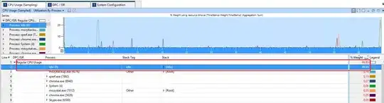

Xperf trace run as admin
https://www.dropbox.com/s/ap684b7ekuv8zq2/HighCPUUsage.zip?dl=0

  • provide a xperf trace: http://pastebin.com/pgE11HRD – magicandre1981 Oct 26 '14 at 07:15
  • magicandre1981: xperf trace run as administrator can be downloaded from https://www.dropbox.com/s/ap684b7ekuv8zq2/HighCPUUsage.zip?dl=0 – BlinkyBill Oct 26 '14 at 07:24

You have no CPU usage in the trace. The CPU is idle for 99%:
Resource Monitor shows 104% CPU usage so this is a bug and you can ignore this.

    @magicandre1981, This is the problem. Task manager and Resource monitor show 99%, while Procmon and this trace show no CPU usage. – BlinkyBill Oct 26 '14 at 07:55
  • @magicandre1981, ok I think I'm with you now. You're saying there's a bug reporting bad CPU readings in task manager/Resource Monitor, as evidenced by the 104%. – BlinkyBill Oct 26 '14 at 08:02
    @magicandre1981, looked into CPU usage > 100%, and it looks like it has to do with CPU performance scaling, so an >100 reading is valid. More detail at http://superuser.com/questions/256921/what-does-the-maximum-frequency-number-mean-in-the-windows-resource-monitor. – BlinkyBill Oct 26 '14 at 08:22
