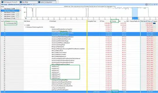

The HDD usage comes from the superfetch service which preloads data from the HDD into the RAM:
Starting with Vista this service loads data into the RAM to speedup the performance of Windows. Also starting with Vista, the IO activities also have priorities like processes. And superfetch runs at very low priority. So it should not affect other IO activity, because normal IO activity runs at a high priority.
I can see that you have some 3rd party drivers running, maybe this impacts the HDD performance. Remove them and see what happens.
If this also doesn't speedup the performance, replace the WD Scorpio Black (WDC WD5000BEKT-75KA9T0) HDD with a SSD.

  • which 3rd party drivers? please tell. i am having issues so i am complaining. It is not minor effect. it is huge effect on performance. really. – Programmer Oct 30 '14 at 21:33
  • look the picture: eubakup.sys and eubkmon.sys. Looks like both are part of EaseUS Todo Backup. – magicandre1981 Oct 31 '14 at 07:51
  • I know they are part of it. So should i disable EaseUS Todo Backup Service name "EaseUS Agent Service"? – Programmer Oct 31 '14 at 08:38
  • EUBKMON.sys is a Windows driver. A driver is a small software program that allows your computer to communicate with hardware or connected devices and EUBakup.sys is an important file process that locates in the Windows\System32\ or folder, it guarantees Windows system's stability and the function of program that require this file process. Both are not EaseUS Todo Backup files. – Programmer Oct 31 '14 at 08:41
  • they are not part of Windows. I don't have them. Remove the backup tool and see if the HDD issue is gone – magicandre1981 Oct 31 '14 at 08:44
  • I got these definitions from internet. Anyways. Anyways, instead of uninstalling EaseUS Todo Backup application (because i use it for the backup tasks), i have disable both of its services named "EaseUS Agent Service" and "Guard Agent Service" – Programmer Oct 31 '14 at 08:51
  • Where did this picture come from? What utility produces it? – Eric Dec 01 '16 at 02:23
  • @Eric this is the WPA (Windows Perf Analyzer) to show the content of the ETL file which he generated with those steps: http://pastebin.com/AyxAVU60 – magicandre1981 Dec 01 '16 at 05:12
