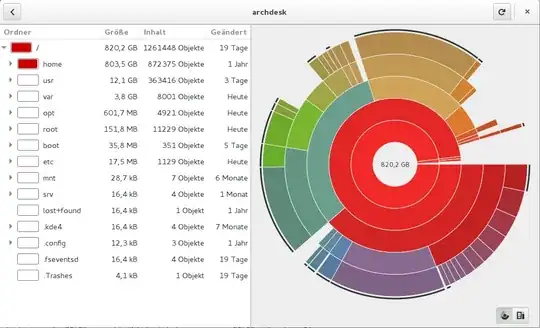

Edit: Thanks for the hint on Baobab. Other System but similar configuration
baobab
As one can see, there are 12G for /usr and 4G on /var that sums up to 16G but du says 49G.
