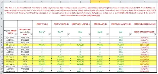

SHARING A LITTLE LONG BUT MUCH EASIER SOLUTION TO SUBJECT..... No need to run macros or geeky stuff....simple ms excel formulae and editing.
mixed dates excel snapshot:
  • The date is in the mixed format.
  • Therefore, to make a symmetrical date format, extra columns have been created converting that 'mixed format' date column to TEXT.
  • From that text we have identified the positions of "/" and middle text has been extracted determining date, month, year using MID formula.
  • Those which were originally dates, formula ended with ERROR / #VALUE result. - Finally, from the string we created - we have converted those to dates by DATE formula.
  • #VALUE were picked as it is by IFERROR added to DATE formula & the column was formatted as required (here, dd/mmm/yy)
* REFER THE SNAPSHOT OF EXCEL SHEET ABOVE (= mixed dates excel snapshot) *

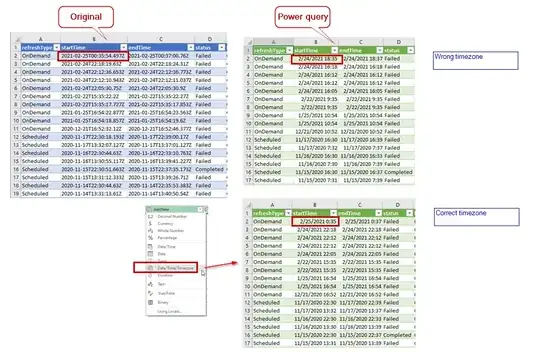

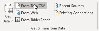

No answers here have suggested Excel Power Query. I had a DateTime value (e.g. 2021-02-25T00:35:54.497Z) that excel couldn't interpret correctly. I needed both date and time. In a new Excel workbook, I used the "Get Data > From CSV" option to load into Power Query. Then loaded the results to excel sheet and the date values are recognized correctly. Note that type datetime vs type datetimezone makes a difference. I had to datetimezone to get the correct result.
Power Query - automated script from "Excel > Get Data" GUI
let
    Source = Csv.Document(File.Contents("C:\myFolder\DataSet_RefreshHistory.csv"),[Delimiter=",", Columns=7, Encoding=1252, QuoteStyle=QuoteStyle.None]),
    #"Promoted Headers" = Table.PromoteHeaders(Source, [PromoteAllScalars=true]),
    #"Changed Type" = Table.TransformColumnTypes(#"Promoted Headers",{{"refreshType", type text}, {"startTime", type datetimezone}, {"endTime", type datetimezone}, {"status", type text}, {"ReportName", type text}, {"WorkspaceId", type text}, {"serviceExceptionJson", type text}})
in
    #"Changed Type"
GET DATA
BEFORE and AFTER
