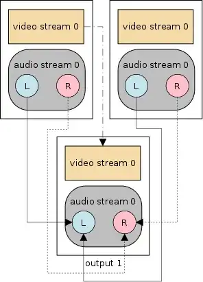

Combine two audio streams into one
ffmpeg -i vid.mkv -i aud.mp3 -filter_complex "[0:a][1:a]amerge=inputs=2[a]" \
-map 0:v -map "[a]" -c:v copy -c:a aac -strict experimental -b:a 192k -ac 2 \
-shortest out.mp4
  • Filtering requires re-encoding, and the amerge filter is used here, so the audio can not be stream copied in this example.

    @aaronk6 The original question requested a way to map multiple audio streams to the output. The example takes the first audio stream from the first input, and the audio stream(s) from the second input and maps them to the output. It appears some are assuming that the example makes an output with a single audio stream and are then confused. – llogan Feb 25 '15 at 16:57
  • @aaronk6 Added an example to combine two input stereo audio streams into one output stereo stream. – llogan Feb 25 '15 at 23:29
