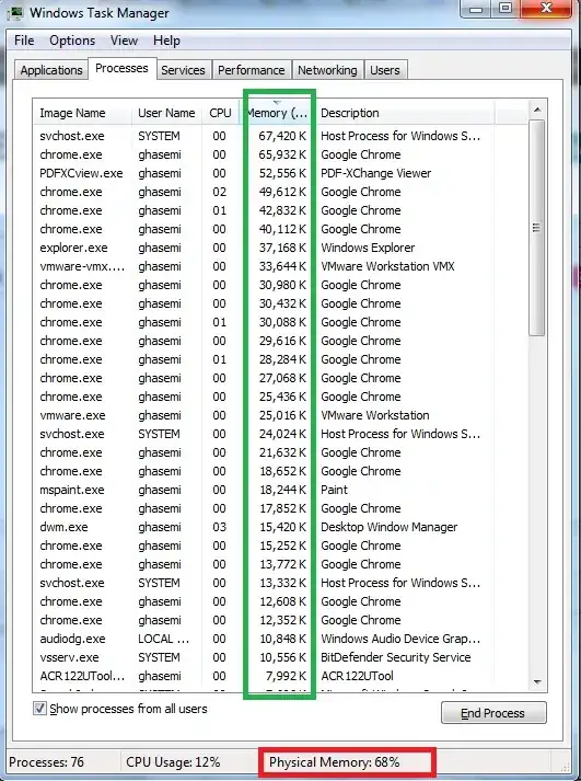

I sum the value of used space memory by each process (all of them) that is showing in TaskManager and I understand that the sum of them is not really 68% of my memory card that is shown in the below!

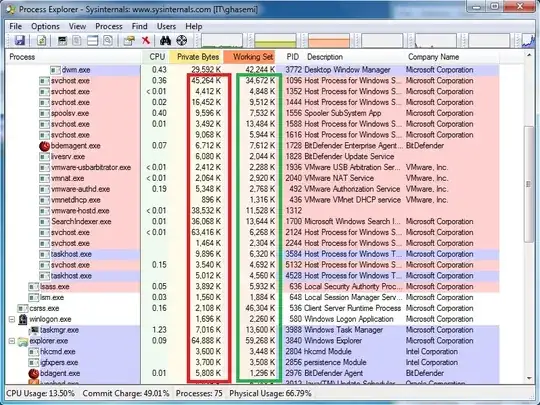

So I install ProcessExplorer and I see that there is two column! Private-Bytes and Working-Set, And what that shown in the botom of TaskManager, is the sum of PrivateBytes, not Working-Bytes :
Q1 : I want to know what is this Private-Bytes? What is the difference with Working Bytes?
Q2 : When I change the priority of a process, what changes? I change the priority of a process from LOW to RealTime, but both PrivateBytes and WorkingBytes not changed

Private Bytes refer to the amount of memory that the process executable has asked for - not necessarily the amount it is actually using. They are "private" because they (usually) exclude memory-mapped files (i.e. shared DLLs). But - here's the catch - they don't necessarily exclude memory allocated by those files. There is no way to tell whether a change in private bytes was due to the executable itself, or due to a linked library. Private bytes are also not exclusively physical memory; they can be paged to disk or in the standby page list (i.e. no longer in use, but not paged yet either).
Working Set refers to the total physical memory (RAM) used by the process. However, unlike private bytes, this also includes memory-mapped files and various other resources, so it's an even less accurate measurement than the private bytes. This is the same value that gets reported in Task Manager's "Mem Usage" and has been the source of endless amounts of confusion in recent years. Memory in the Working Set is "physical" in the sense that it can be addressed without a page fault; however, the standby page list is also still physically in memory but not reported in the Working Set, and this is why you might see the "Mem Usage" suddenly drop when you minimize an application.
Virtual Bytes are the total virtual address space occupied by the entire process. This is like the working set, in the sense that it includes memory-mapped files (shared DLLs), but it also includes data in the standby list and data that has already been paged out and is sitting in a pagefile on disk somewhere. The total virtual bytes used by every process on a system under heavy load will add up to significantly more memory than the machine actually has.
So the relationships are:
  • Private Bytes are what your app has actually allocated, but include pagefile usage;
  • Working Set is the non-paged Private Bytes plus memory-mapped files;
  • Virtual Bytes are the Working Set plus paged Private Bytes and standby list.
