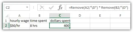

Another method is to use VBA together with Regex and a fitting pattern.
For example, the \D pattern matches everything which isn't a digit (0-9).
  1. Insert this code into a VBA module (ALT+F11). The UDF needs 2 arguments when called from Excel: The input cell and the RegEx pattern to check against. Then, the code removes every character which matches the given pattern.
    Function Remove(objCell As Range, strPattern As String)
        Dim RegEx As Object
        Set RegEx = CreateObject("VBScript.RegExp")
        RegEx.Global = True
        RegEx.Pattern = strPattern
        Remove = RegEx.Replace(objCell.Value, "")
    End Function
  2. Back in Excel write your formula in this syntax to a new cell
    =Remove( <cellToCheck> ,"<regExPattern>")
I've taken your example to multiply two "non-digit" cells: $50/hr * 8 hrs = 400
However, this won't work if you have multiple (unintended) numerical values in one cell e.g $50/hr2
